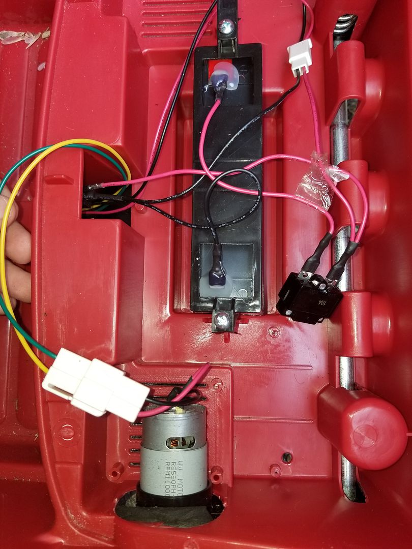

I am curious if anything ever came of this? I am very interested in doing this to my son's Mickey Mouse roadster racer. It does have a board for lights and sounds so as mentioned already I was thinking of keeping the 6 volt battery to run those and adding a 12 volt battery to power the motor. Attached is a picture of the battery area wiring. I am a complete noon to this so what would some of you experienced guy's recommend doing?

I'm looking at that now too. I don't think there is enough room for a full 12v battery and a 6v battery, but there could be hope for the 12v version of the same maker's battery. If you look, the plastic seems to be molded for a larger battery. I'm not sure if the electronics would be happy with just a 12v or not yet, but it looks like the 6v downgrade might have been an afterthought.
I found this and it looks like it might just fit in the place of the 6v. http://a.co/0WCZ4nc
There appears to be room under the hood for a battery or two, but we'd need a way to hold them up there and protect them a little.

Conversion completed. It went as well as can be expected. I picked up a 12v to 6v power adapter and a 6v relay. Hooked it all up and the thing will torque the front end around when he hits the gas. One wheel drive and rubber wheels don't help there. The gearbox lasted about 20 minutes and now it is clicking. I'm looking at going down the rabbit hole of upgrading all that and possibly even going with 2 wheel drive.
The battery connects to the relay and the 12v-6v converter. I'm using the wires that went to the motor to feed the relay, so when the relay turns on it pumps straight battery power to the motor. The downside of this setup is that the car no longer goes in reverse. I could fix this with another relay setup or maybe opening up the front of the vehicle and altering the wiring there to handle 12v. I just didn't want to push the electronics.
