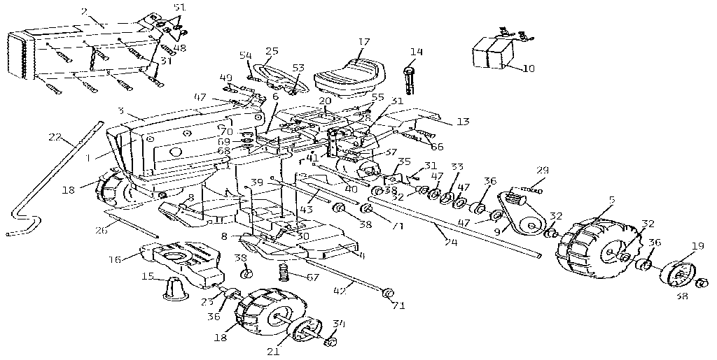

Hello,
Picked up an old circa '93 Hedstrom brand tractor. Missing some connectors, and no battery, but I would like to get it running. Absolutely no info online except a parts diagram on sears website. Does anyone have a wiring diagram for this? Looking at the diagram it seems it used 2 6V batteries. Its very odd as it has 2 pedals, and 2 gear selector switches. Perhaps the gear selector switches switch from 6v to 12V for high speed/low? Image

Never seen one but all these things are pretty much wired the same.
My un-educated guess would be that the two pedals are meant to be inter-locked. i.e. have to have both of them down to go. Not really necessary. You could use the other as an electric brake pedal. Paint it red.

Ah that makes sense. I may have had it wired fine then, but didn't try both pedals at the same time. 2 separate levers likely rev/fwd and hi/lo. Only seen 3 stage single levers with Rev/Hi/Lo before. I'll post what I find.
