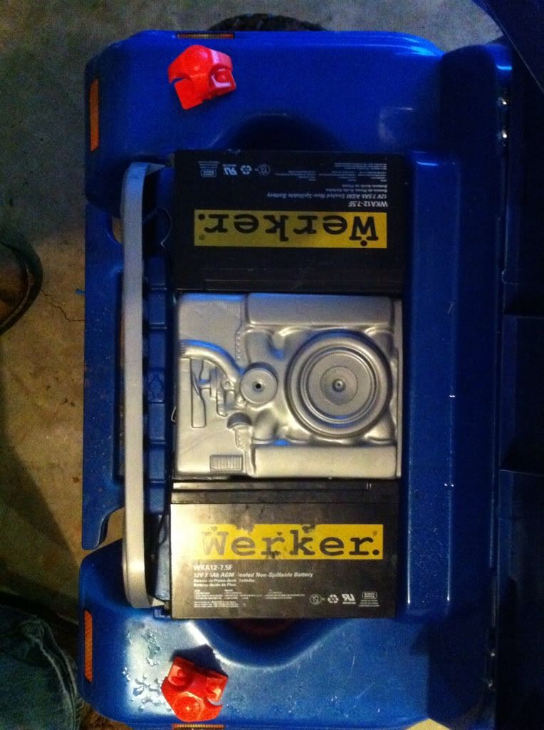

Cleaned up under the hood by using the stock "engine" battery cover. I trimmed it to fit between the 2 batteries to hide the wires
