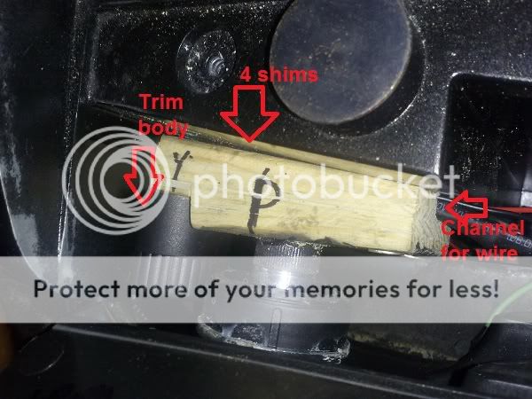

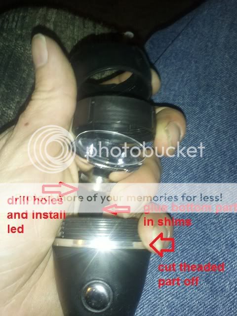

By vinnysdad
#83460
Sorry kinda spaced it. I'm not a good writer. hopefully the pictures will show how i did it. Ask questions if needed
Materials
3 pack of Rayovac flashlights. 2 small and 1 large from warmart. $8 i think
2 smaller $2 flashlights. also from walmart
1 Pack of wood shims. The kind used to shim doors or windows when installing them. From home depot $2
4 leds $10ish
some notes
I used 4 shims per side to get everthing level with the "radiator support".
it took some expermation to find the right thickness, so that the flashlight lens didnt hit the grill
A notch was needed for the outer lens.
The bulb holder was glued in the shim base with jb weld.
The threaded portion of the flashlight "handle" needs to be used to secure the lens.
I just used electral tape around the wires below the leds to fit into the refelctor.
took me a couple of hours to figure and make one side and about 15 min to make the other :lol:
channel on bottom bottom for wires.
IMO, once you got the shim base thing down the rest is easy.
