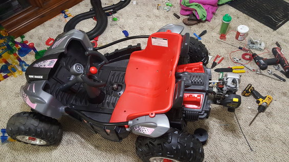

Pre project note: I reused some of the original metal frame. It is galvanized. You MUST remove the coating with acid before welding. Use appropriate gauge wire, USE FUSES, solder connections and seal from elements.
This started out a few weeks ago as a $25 Craigslist dune racer. I have a 3 and 4 yo and they needed an upgrade from their old 6v ride on.
After taking apart and cleaning all the switch internals, cleaning and greasing, it ran perfectly. The only problem was the run time. 2 kids+ hills and 3 acres, meant unhappy campers when it ran out of juice. Added as many batteries that I could, but it wasn't doing what I needed it too.
I wanted to retain the auto braking, speed control and reverse (for now) that the power wheels had.
Version 1: 25cc
Not about to spend a bunch of money on batteries, forever, I started searching. I found, essentially, a string trimmer engine mated to an alternator.i decided this is how I would fight the battery.
Found a new (closeout/overstock) alternator locally for $25. I had a 25cc trimmer engine laying around, and slapped it together.
Did some welding and wiring, and the first version was done. The engine was running flat out, and was charging the car, and providing power. Except it only worked on slow. Going into fast would bog the engine and stall it.

Version 2: 79cc 4-stroke
Since my proof of concept worked, the only thing left to do is what I do best: go overboard.
IF I could find one, people wanted insane prices for 35cc, 4-strokes. Screw it. Harbor freight has a 79cc (3hp) 4 stroke for $99.
Using my observation skills, I noticed this engine was much larger and heavier (22lbs), and wouldn't "hang off the back". Only one thing to do: strip it and do the frame. 16ga x 48" was perfect, and the drill press took care of the holes.
Made a rear extension and some cross braces for the engine and strength. Engine is contained within the outer frame providing: a bumper, buffer from parts, and wheelie protection. Wheelie bars will be added if needed, I don't think they will though. All of the spinning mating adapters will be hidden in the rear "engine" cover.
My son wanted a hitch, so I took some of the tube, squished the end in a 20 ton press, grind it round, drill hole, weld end shut and done. Perfect hitch. Added a hook too, for general stuff.

ITS ALIVE (and works)
Just finished the build (so far) for my new proof of concept with the 79cc engine. I feel kind of bad, my son had just gone to sleep, but I promised him he could ride it today. So, I woke him up. In a foggy state, he was able to drive around the yard so I can see any adjustments. Ill get a better video of him driving tomorrow.
Not sure yet, being how it was used and I never checked the condition, I may have stripped the gears. Don't really care, was planning on upgrading anyway. Could also have been a operator error.
Im not even sure how many times I took this apart and put back together to test fit; it was a lot. Motor and alternator are mounted on rubber vibration isolators, alternator exciter switch on back cover, back "engine" cover fits perfectly to conceal the alternator. Dynamat was added to back of seat for a "firewall"/heat shield, mostly because I had it laying around and I was waiting on my oven. Air intake for cooling alternator was added, ill be adding dc fans. Ordering the new gears and motors tonight and will install asap. Ill also order a new header pipe and building a kid safe, quite exhaust.

Conduit/reservoir
Going to make a grill for the front.
Waiting for nap time and the rain to be done to try it out. I already know that the poti ometer has problems because it doesn't give full range of speed so I have to replace that. Since it only affects low and reverse it doesn't really matter, it just won't slow crawl yet. High/low/reverse and throttle/brake all work like stock. Still have some wires to loom once I know it all works, and some other changes too
#149640
Ack, at 14V? Sorry to hear that, especially after all that work. Even with higher-torque motors I'm a bit surprised -- assuming the ESC is limiting to 100A, the overall torque isn't going to be much more than stock, and you have soft start. Were there any big impacts (bumps/hills)?
#149644
Hammer-fm wrote:Ack, at 14V? Sorry to hear that, especially after all that work. Even with higher-torque motors I'm a bit surprised -- assuming the ESC is limiting to 100A, the overall torque isn't going to be much more than stock, and you have soft start. Were there any big impacts (bumps/hills)?
I cant really say im suprised, its like any other project. just keep fixing until it works. It did have soft start, and esc is on the 100amp breaker, so im assuming things worked as they should. It was a used craigslist score, so im not sure of previous use. For now, ill replace the gear and see what happens. If not, ill have to figure something else out.
while it was running, seemed pretty fun. Made some adjustments, still making adjustments. the extra weight of engine on the back made it swing like a pendulum, especially when it wound up to full power.
#149655
So, I ordered replacement gears, but fear I will keep having this problem. So I started sending out emails to gear makers to see what they suggest as material, and approximate cost.
While searching, I found this guy that cast his own parts. https://www.instructables.com/id/resin- ... er-wheels/
Not sure how it turned out, but I started looking into it. Not sure of the material yet, but maybe carbon fiber reinforced resin or something.
#149659
I broke a final gear a few months after I got my first vehicle (Hurricane w/13T gearbox), doing an experiment to try to reduce the amount of slop between the wheel driver and the gearbox gear. I broke a few other gears over a few months after that, but haven't broken any in about a year. Amazingly, that was the only final gear that broke, even with substantially more power and torque vs. stock, in the F150 and Mustang (granted, the Mustang has somewhat "slippy" tires).
I don't know whether to chalk your gear failure up to too much torque, bad luck, or a defective gear (someone - I think GloryDays -- had posted one of his and there was a large bubble in the gear material at the breakpoint -- clearly a casting failure at the plant). I do think generally the factory plastic is pretty tough. Casting anything stronger may be somewhat difficult.
I have a stash of 6 brand-new gearboxes in the garage to use for spares and I haven't had to use any -- knock on wood. It's nice that all of the gears interchange with each other (as long as it has the 7R boxes).
#149661
Hammer-fm wrote: (someone - I think GloryDays -- had posted one of his and there was a large bubble in the gear material at the breakpoint -- clearly a casting failure at the plant). .
After you said that I checked. What do you know? A massive bubble under 3 gears. At least I feel there is hope for the stock gears now.
#149662
Another option to consider for the future -- if you determine that you have plenty of torque to spare (which I think should be the case) -- is to move up to a larger motor pinion. The Dune Racer is 15 or 16T stock, right? You could buy a case for a Mustang (18-19-20T) or Corvette (21-22-23T) and swap gears over -- or get a whole gearbox so you have more spares. Then buy the appropriate (19/22T) gear for your motor and bore out the axle hole. This will decrease the torque at the gearbox (less stress) and get you more speed.
#149671
Hammer-fm wrote:Another option to consider for the future...
Definitely going to do that in the future. Right now kids are still learning how to drive it as is. During the testing, my son ran into a tree. Instead of reversing, he tried going forward. Ended up having enough torque that the front end started climbing.
I got, well one at a time (20% coupon), harbor freight 13x5 tires with rim for the front. 7/16x5/8 sleeve bearings to mate up. I'm only going to do the front, try and control the torque steer and push. I think I can saw the back off the stock rim, use the piece as a spacer, and mount the cap on the rim. This should give it a more stock look. I may end up filling them with windshield washer fluid for more weight in the front.
New gearboxes should be here Saturday.
#149679
installed the new gearboxes and the kids drove around for an hour +. So far no problems, still adjusting throttle and other small things. Left off the hub caps on the front, but the rubber tires make a huge (HUGE) difference in handling. He swallowed a bug or spider and was trying to spit it out, almost ran into a tree; you can see him swerve at the last minute.
Through all this, im still on the original tank of gas. ~2 hours so far?
#149685
Looks good! Hopefully the new gears will last for a good while. Great to have a large yard and a way for the kids to help while still having fun!
We showed up last Christmas a the nearest tree lot with the PW truck one day with a hacked-together trailer on the back. It was pretty funny to see the reactions... (the trailer was a bit small for the tree, so I got to stabilize it all the way back to the house... glad it had a variable-speed controller).
