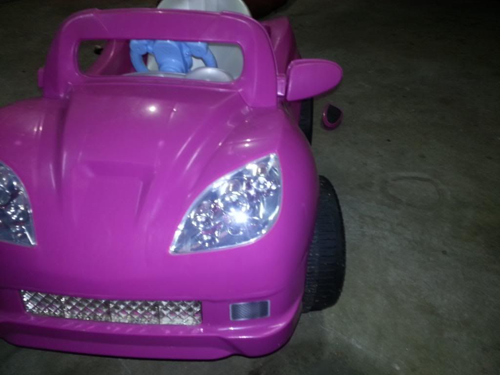

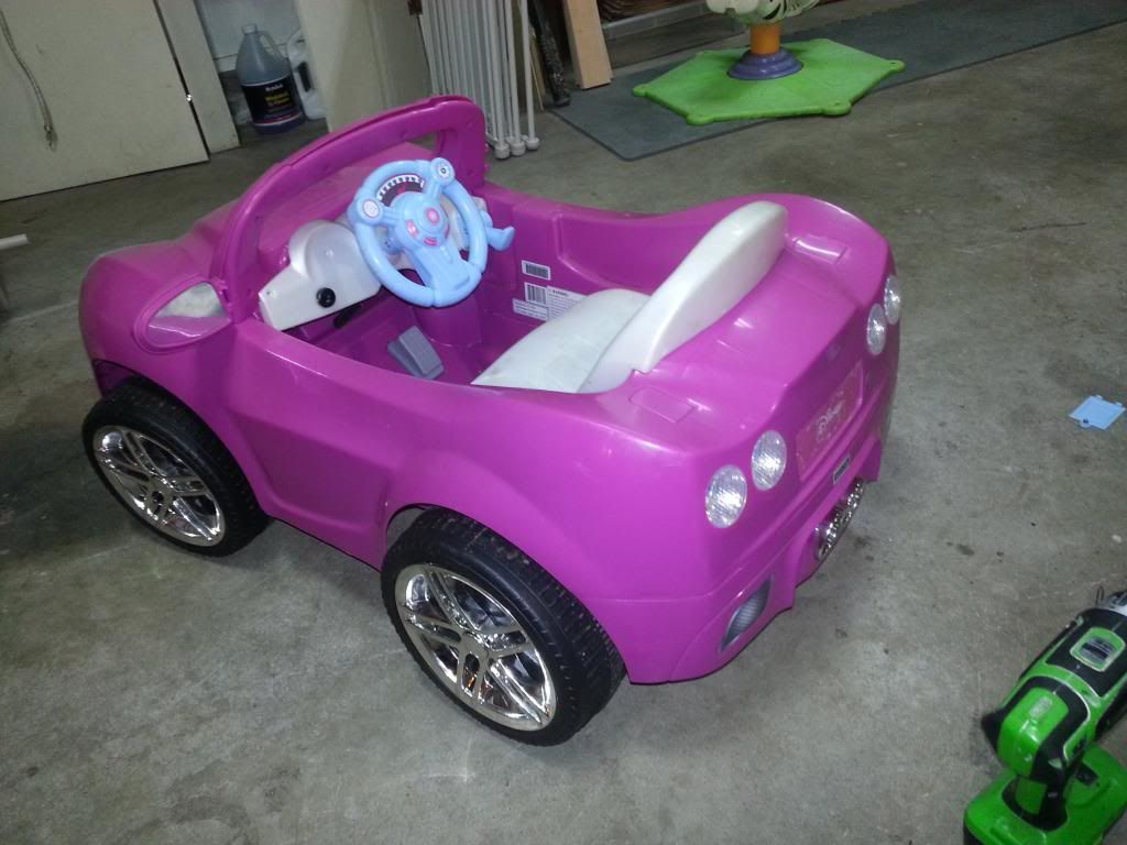

Here's what I started with:
http://www.walmart.com/ip/Disney-Prince ... ifications
It is 6v, but I ordered x2 6v battery replacements and will place them inline to each other, to make it 12v.

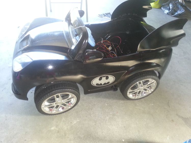

From there, I removed all decals/stickers and took the unit completely apart. I mean completely.
I then sanded down all components to be painted, first with 150 grit, then 220 grit sand paper. Once sanded, I sprayed everything off with a hose, to make sure all loose particles were gone. After allowing to dry, I cleaned off all surfaces with windex, using blue shop towels to ensure no loose particles would be left over.
While I was waiting for all parts to dry, I constructed a make-shift painting-box, to make sure I didn't get paint all over my garage.
Once this dried, I started to paint. I used Krylon Fusion Black Gloss, as I have had a lot of luck with KRYLON Fusion in the past, when used with plastic. I painted several coats of black, very lightly. Once I was happy with the black, I then sprayed with clear coat, again several light coats

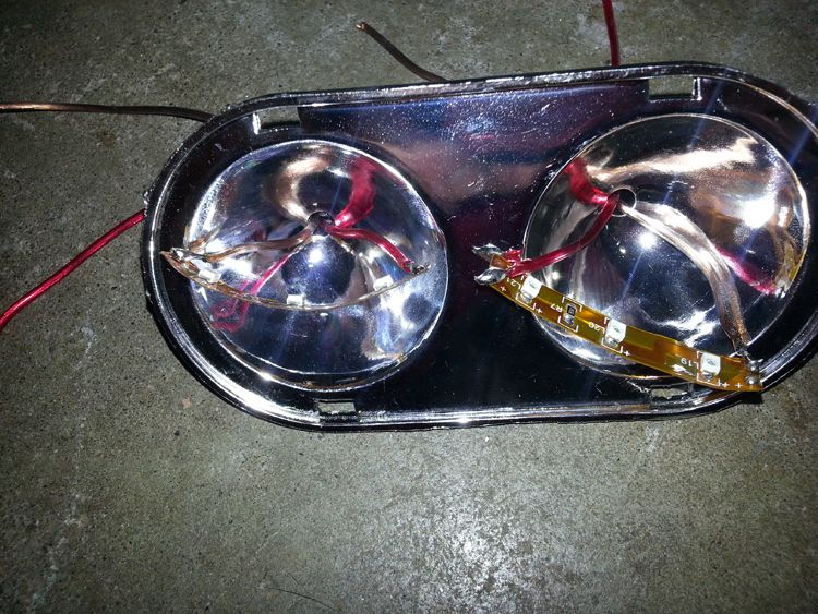

Since I was adding headlights, I drilled the holes out larger for some LED bulbs, and test fit them. After I verified they would fit, I cleaned them up a little.

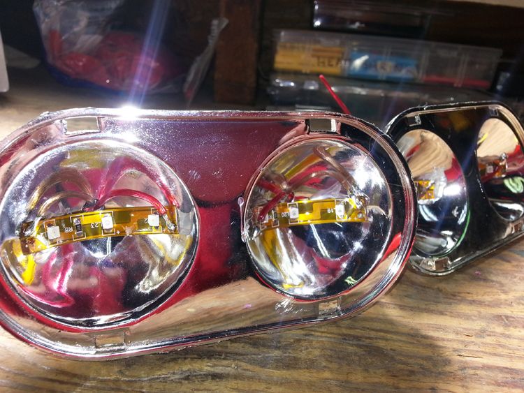

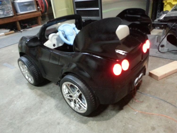

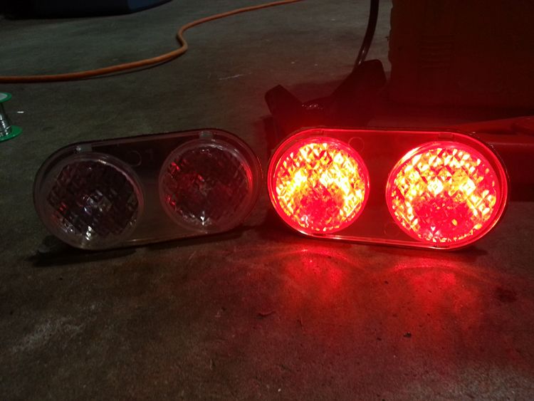

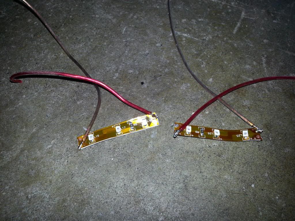

I added tail lights, but for this I used red LED 'tape.' ( http://www.ebay.com/itm/5M-12V-IP65-Wat ... 2a21cfd9a6 ) Although this comes with a 3M backing, I made sure to glue these in the center of each tail light.
I also added 'flame' lights to the exhaust pipe. For this I used the same LED 'tape', but I used red & orange. Unfortunately, it turned out a little darker than I was hoping, but it still looks good. I used an adjustable pulse flasher inline (I had a pretty expensive automotive one lying around that i'll never use, but you can find them on ebay like crazy), the it would glow on and off. I didn't take pictures of this yet, but I will.

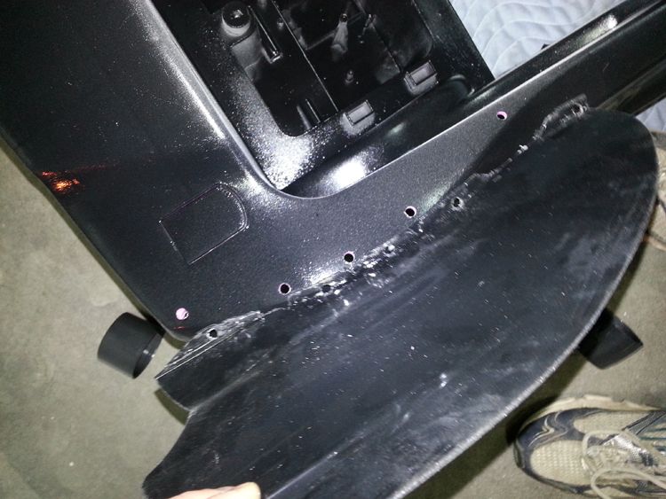

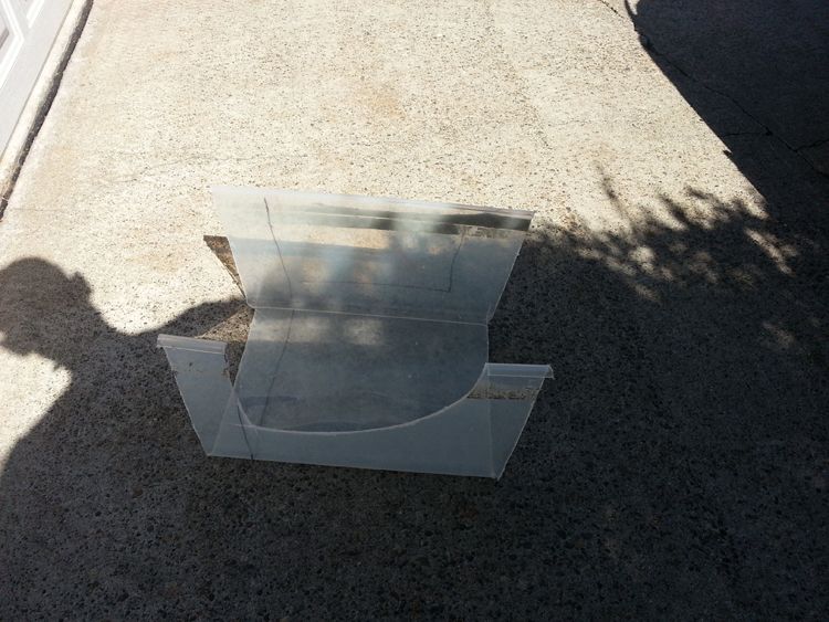

I made bat wings for the rear out of an old plastic tote I had lying around. I cut out the approximate size desired, but in rectangles. Laying the plastic over the handle for a rubber mallet, then holding down it down on each side with other handles, I heated the plastic, holding pressure down around the handle of the rubber mallet, making it mold around the handle, to make the curves. Once the plastic cooled, I cut out the shape of the wings, making sure to leave a little access at the bottom for mounting. When the wings were cut, I heat up the bottom and bent the bottoms to match the mounting location desired on the rear of the PW.
After all of this, I drilled the holes in the new wings and the body of the PW, making sure to follow the curve of the body. Once set, I then sanded/painted/ and cleared the wings to match.
After this dried, I used some typical plastic mounting rivets usually used for automotive body parts.

This is where it's at now:

Sharp looking batmobile! I'm not totally clear how you bent the plastic to form the wings, I'm assuming you heated it, but didn't catch that in your write up.

@Landon: Thank you and thanks for mentioning that, i apparently wasnt paying attention to what i was typing. i edited it:
"Laying the plastic over the handle for a rubber mallet, then holding down it down on each side with other handles, I heated the plastic, holding pressure down around the handle of the rubber mallet, making it mold around the handle, to make the curves."
I still don't like the wording, but it makes sense now!

OMG! :shock: This has to be one of the most thorough reports of a project I've seen! They say a picture is worth a thousand words, yours speak volumes! Great job on the car, you've given me some ideas I want to try myself. I really like the closeup detail pics showing what you did with the lights, that will help a lot of newbies to LEDs out there. I also like the wings and how you made them. I'll bet your kid is thrilled over this, I sure am. Looking forward to more! :D
