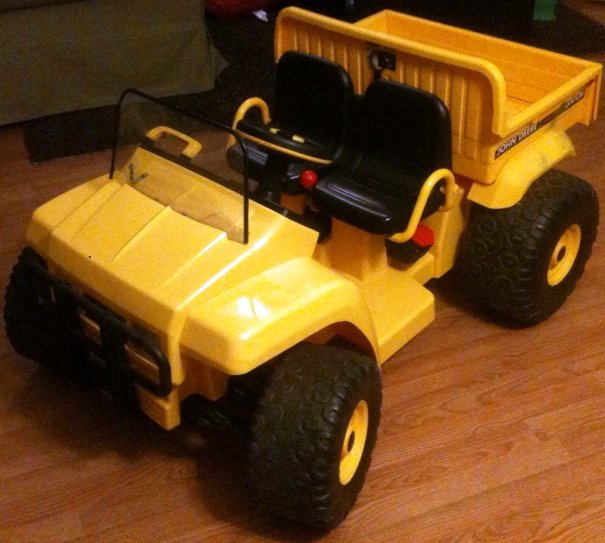

my wife texts me while at work and said someone threw away a john deere gator. so she picked it up and brought it home. i just looked it over and had to take it apart. no power to the wheels. battery is good. found an extra 2 wires coming from battery connection going nowhere, just to a clip resting inside. not connected to anything. curiosity killing me. anyone know anything about this clip. and any suggestions on why no power to wheels. thanks. love this site.

cdavidson001 wrote:my wife texts me while at work and said someone threw away a john deere gator. so she picked it up and brought it home. i just looked it over and had to take it apart. no power to the wheels. battery is good. found an extra 2 wires coming from battery connection going nowhere, just to a clip resting inside. not connected to anything. curiosity killing me. anyone know anything about this clip. and any suggestions on why no power to wheels. thanks. love this site.
The "extra" plug is probably for the electric dump unit - no longer available.
It can also be used as a charge port.
You'll have to trace the wires to be sure, but the most likely suspects are the switches - one under the pedal, and two in the shifter unit.
Peg switches are harder to clean than Power Wheels ones.

dude thank you. it was killing me not knowing what that went to. well i have that done. now im modifing a harley-davidson motorcycle. older ones. i have two. to 18 volts. i heard you need to disconnect or unplug hi-lo switch or something like that. ill have 18 in high and six in low. not sure where that is. i cannot find wiring diagram anywhere for it.
