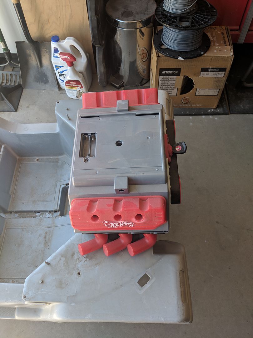

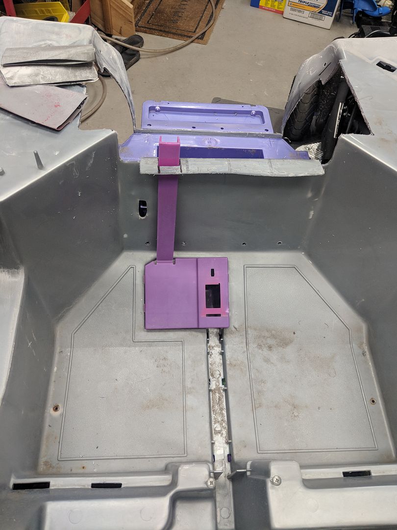

I just finished this build and wanted to share, I had purchased a Hot Wheels plastic toolbox on eBay and decided to showhorn it into a Jeep. The following pictures/build is the result of that effort.

Dash mock up, paint and wiring. LED reflector taillights, finalizing the engine and installing a "dummy" battery in the front to keep some weight up front.

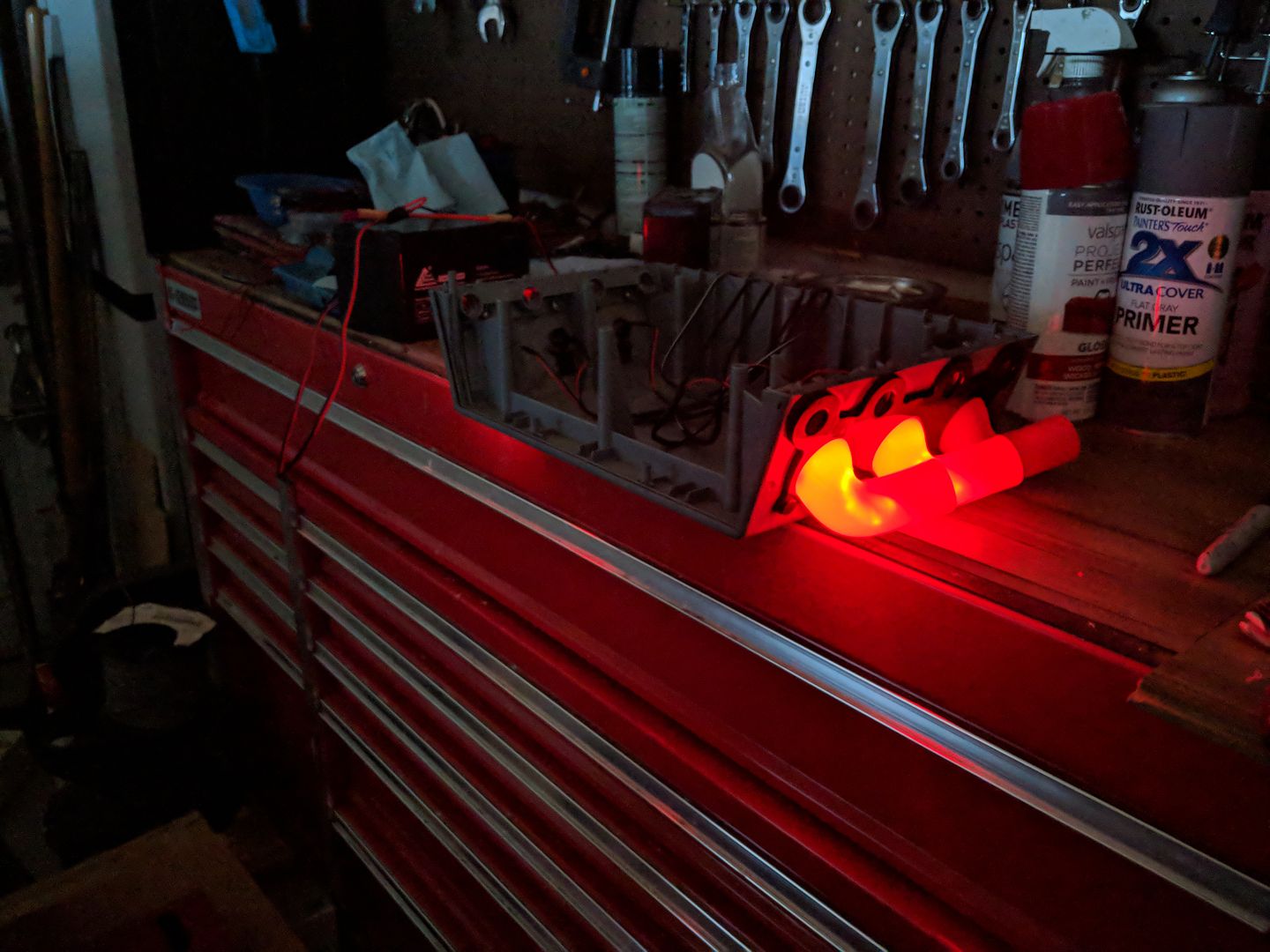

Continuing with the engine assembly, wiring and further assembly.
Strobe controller for the LED's in the headers.

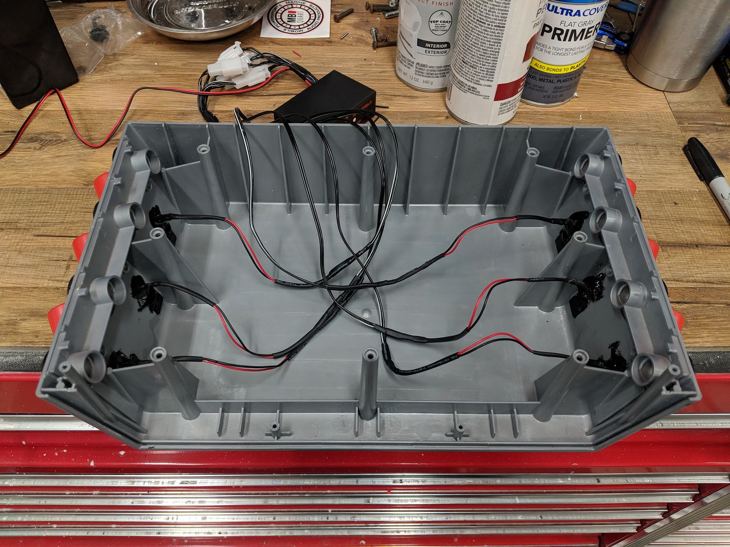

Mocking up the batteries for the 18V drive system, Im using the CJB board.
#150191
I decided to add another terminal strip for the charging and sound effects circuits.

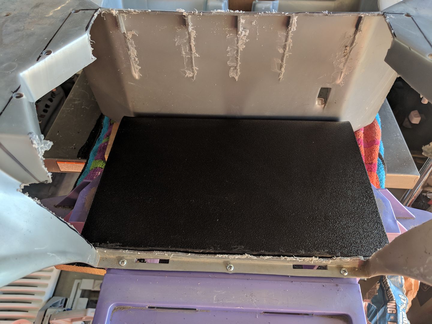

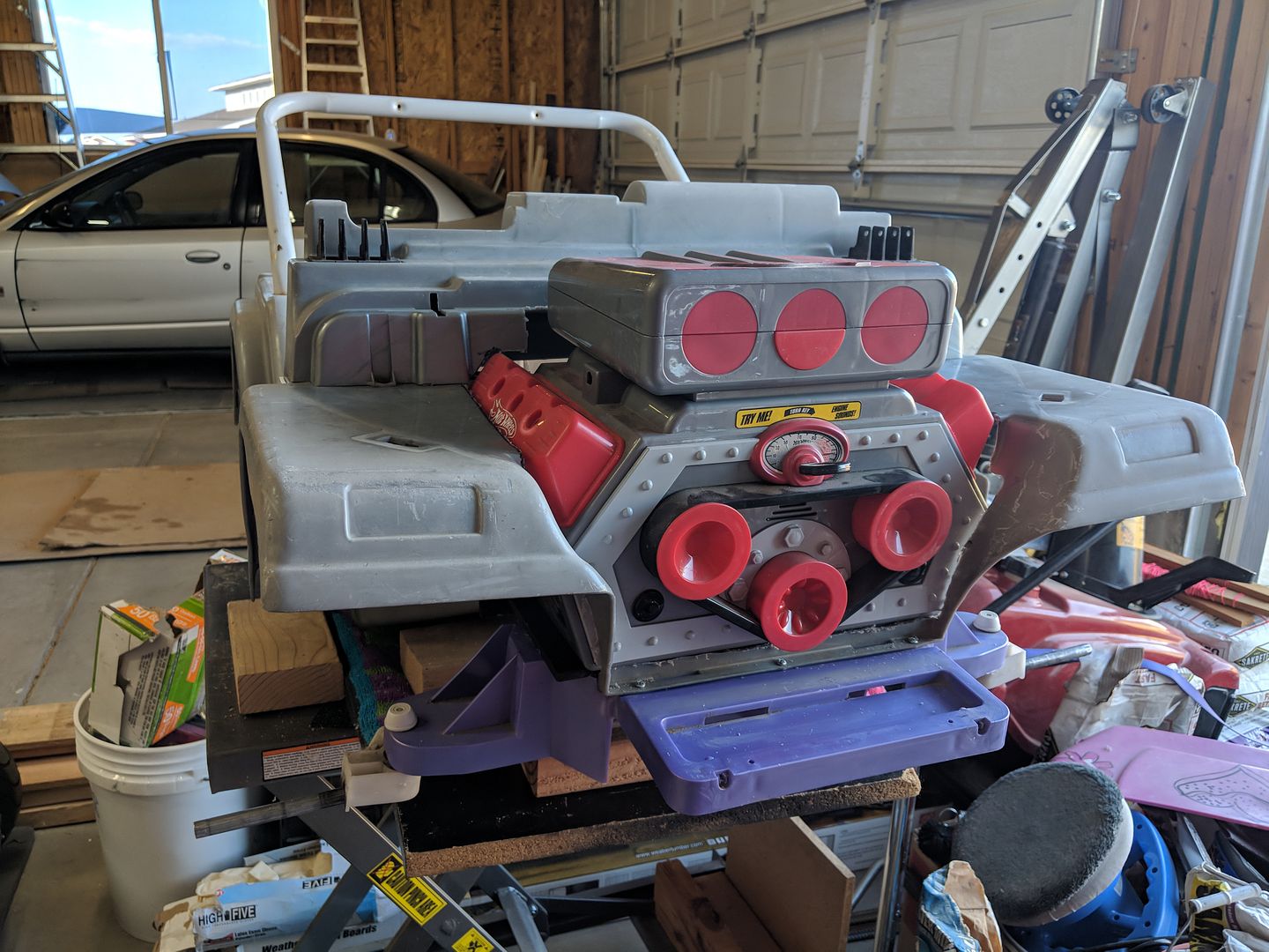

I shaved the driving lights off the bumper for a cleaner look and repainted it correct grey to match the rest of the body parts.

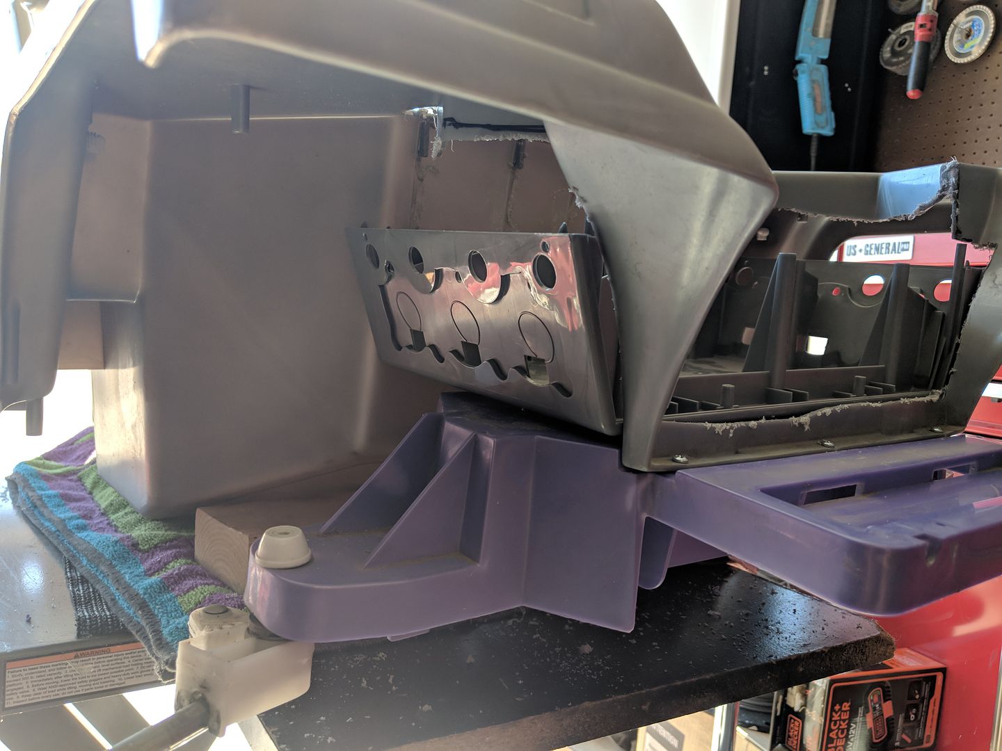

I then modified the hood to fit around the engine. I used aluminum angle to frame three sides of the hood, bolting the pieces together with SS hardware.

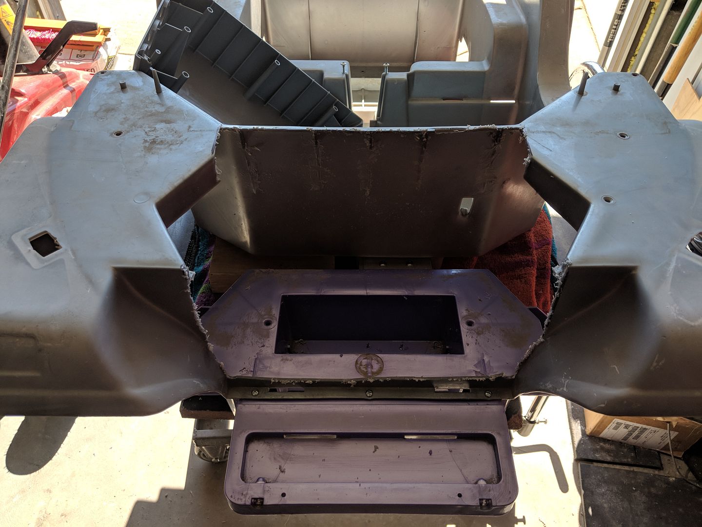

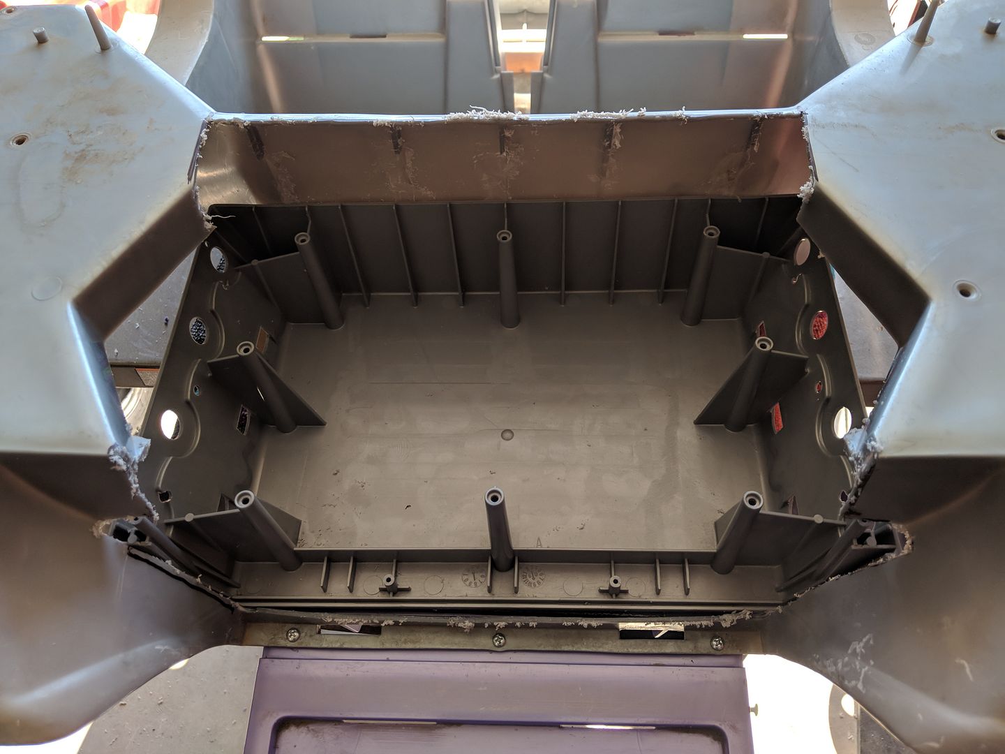

It might appear that way now, I had to a lot of cutting, build a plate to reinforce the front end, clereance the firewall, etc... :lol:

Stock motors/gearboxes on 18v using the CJB 18v Interface Board, it is the circuit board pictured in the rear tub. The board provides individual charing of the two batteries (12v & 6v), 12v ignition switched circuits, relays and option for turbo mode or constant 18v.
