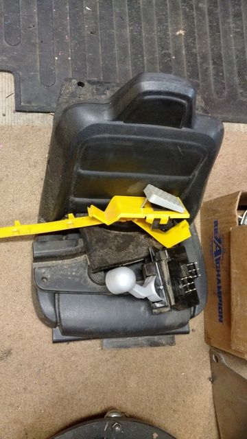

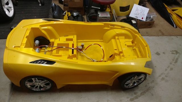

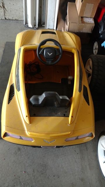

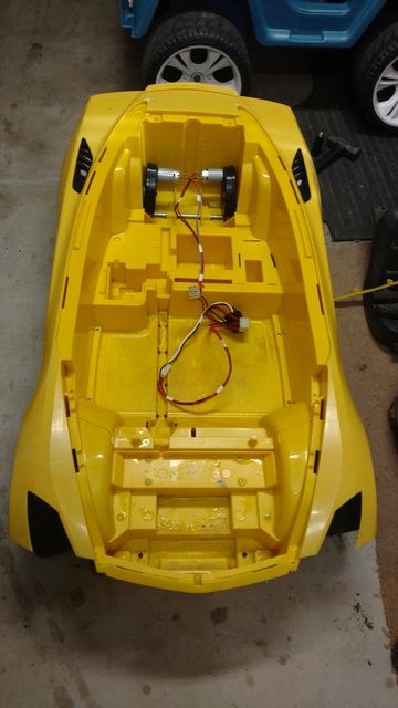

This is another build I did for a special customer, I was approached to make a car for a child that has some disabilities and I was more than happy to give it a shot!
So I picked up a Corvette, made a plan, did some research and built the below.
The start:
Underglow:

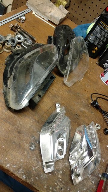

DRL headlights:
#150242

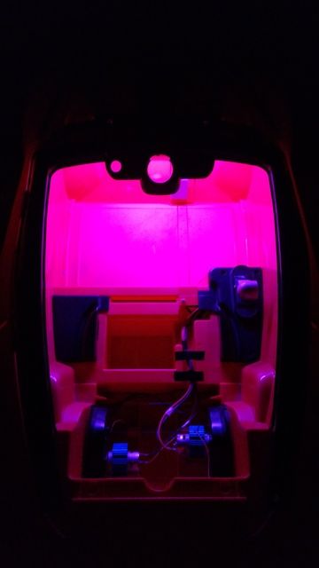

Of course it has to have matching underglow.

I built a steering wheel mounted hand throttle, the driver has limited use of this legs, so he could not operate the traditional throttle pedal.

#150330
Thank you, I believe they were 8mm or 10mm prewired LED's.
