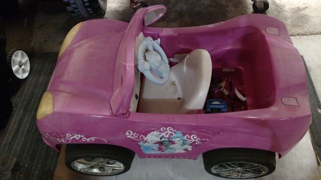

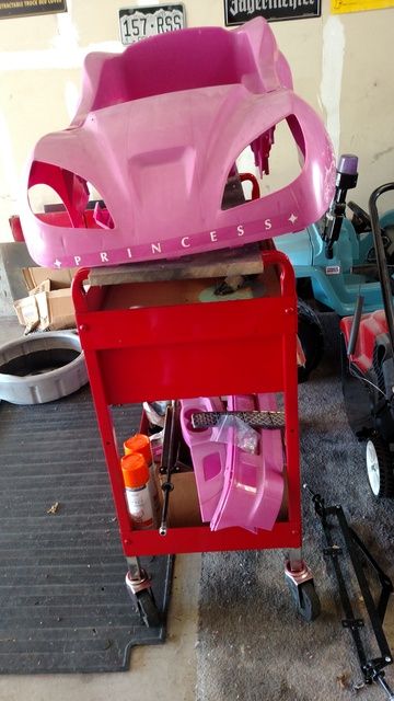

I bought this little Corvette with some other vehicles, didnt really know what I wanted to do with it... I decided to do a full repaint, full lighting, dual motor conversion, the works! Ha Ha
Here is the beginning of the project, not in great shape.
Torn down to the bare shell.

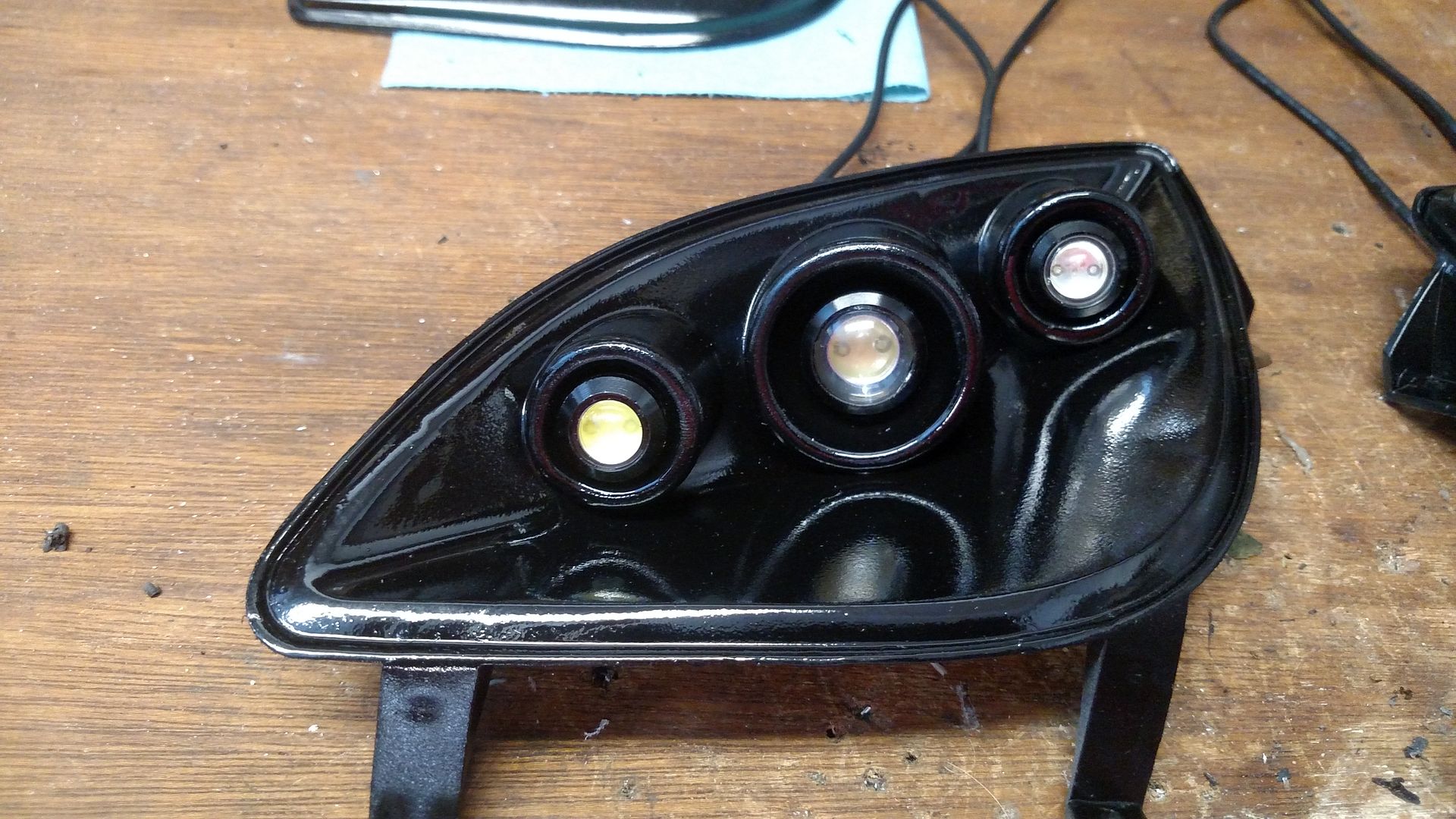

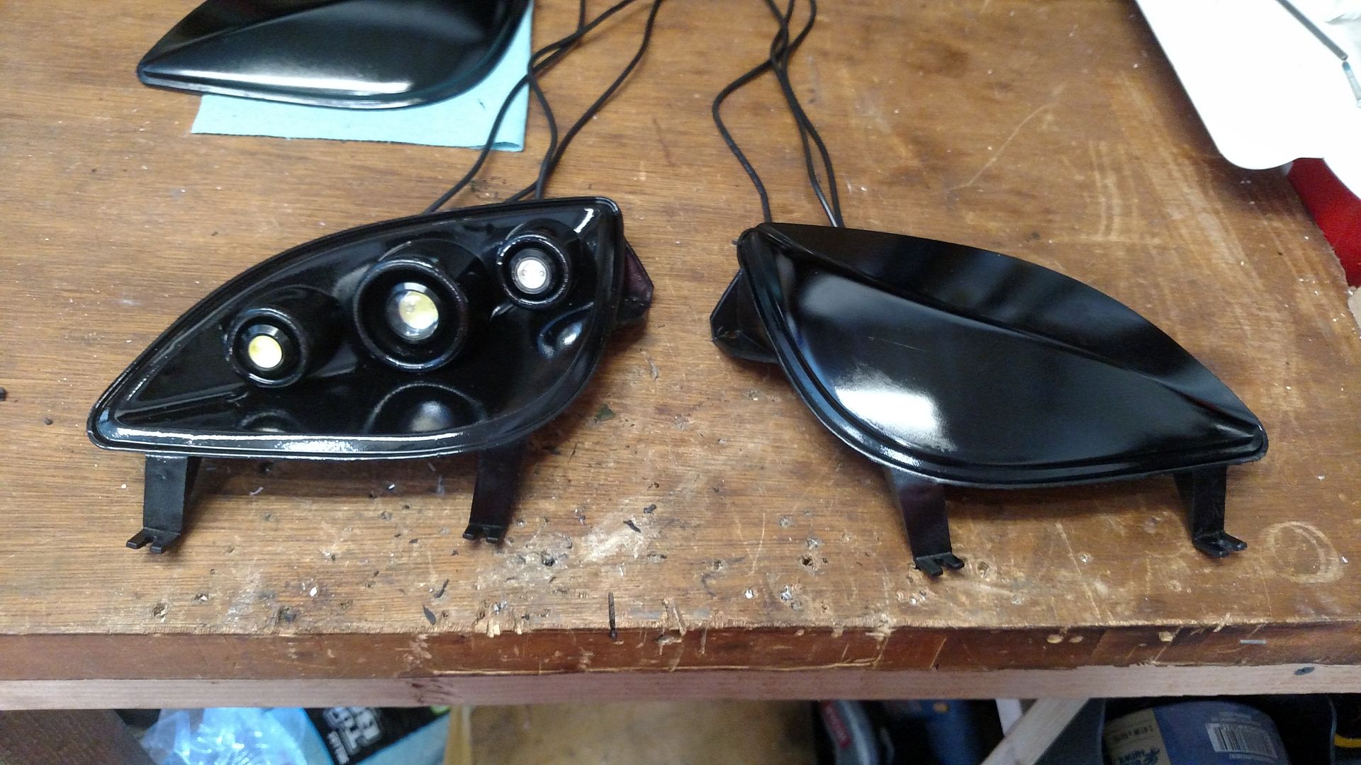

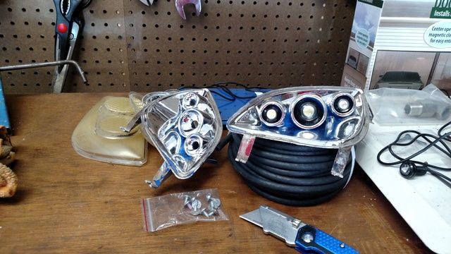

Mocked up the headlights.

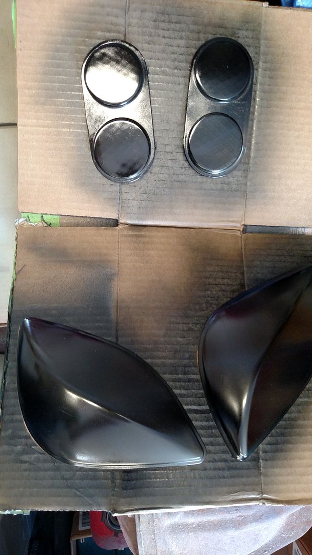

Painted the housings black.

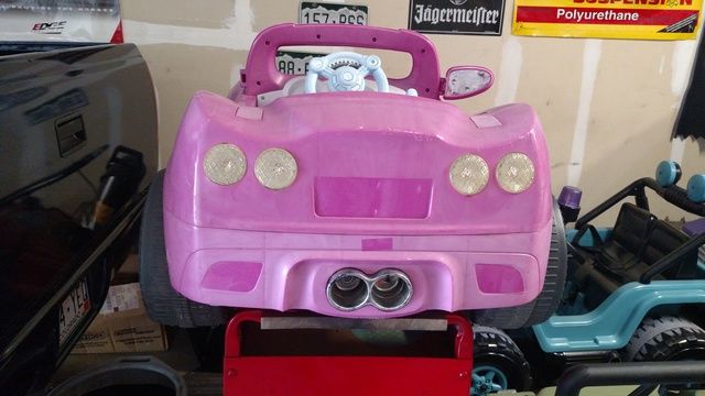

Tinted the lenses, they were in bad shape, I wetsanded them for a long time and did the best I could with them.
