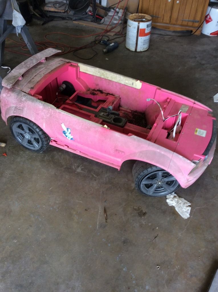

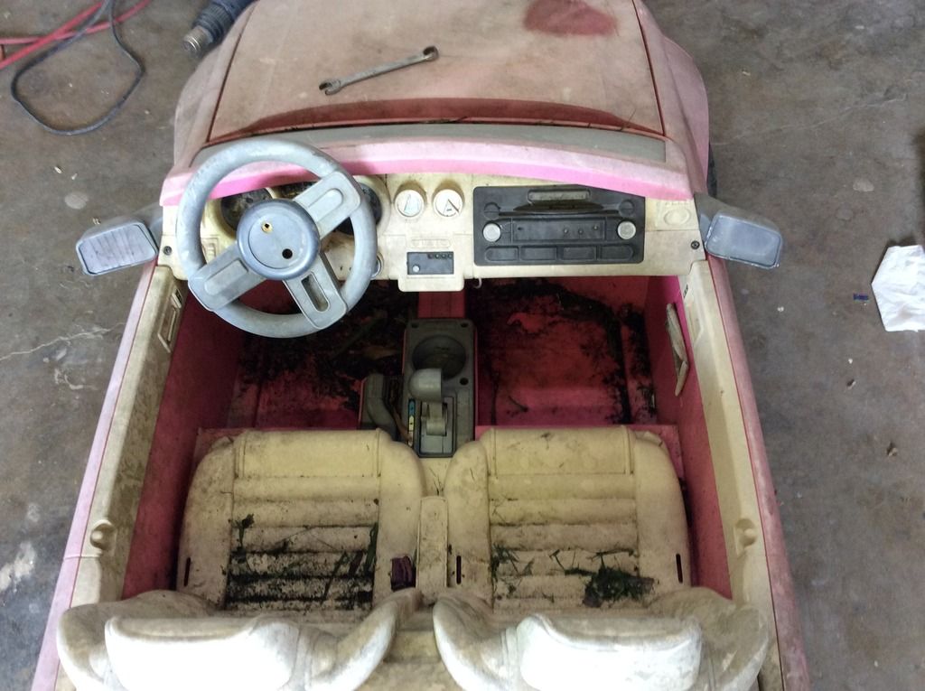

I stumbled across this site surfing the net for my kid a power wheels and had to bookmark it cause my 18 month old loves his 6v atm. I was giving this run down pink Barbie mustang and brainstorming I did. Here are a few pics of the project atm. Image Image Image Image

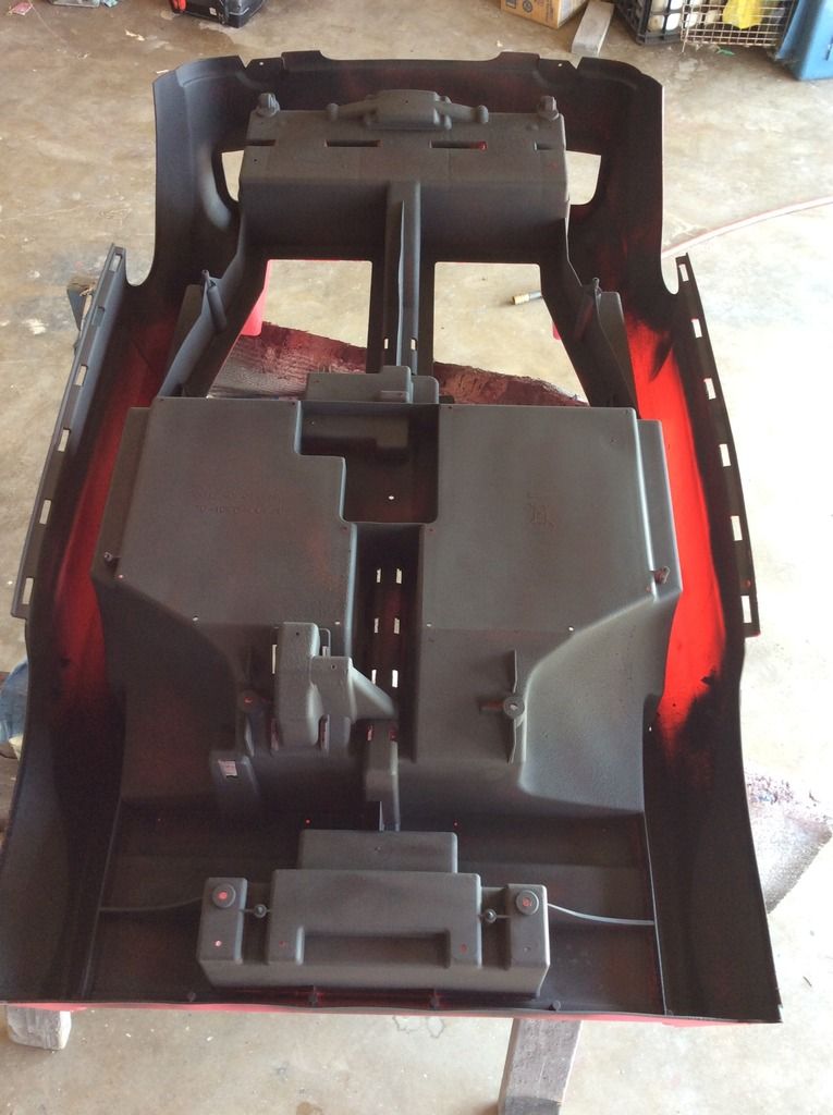

I have the underbody undercoated and that's a visual or final product. also tinted my clear to give my kid the headlight cover look. Image Image that's were am at atm. Items im gonna need will be wheels and a rear spoiler. I entend on salvaging everything else as I like turning someones junk into a diamond

Wasn't allowed a lot of time to work on the car today. I had little bit of bed liner in a can so I decided to roll it on the inside for the abuse that will take in paint over that. I painted my trim a smoke charcoal color in cleared those pieces to offset the matte black that the outside will be. I also picked up a set of tires in boss rims off person in the Facebook group. Those rims look more like my picture so I'll use those over my 5 spoke ones.
