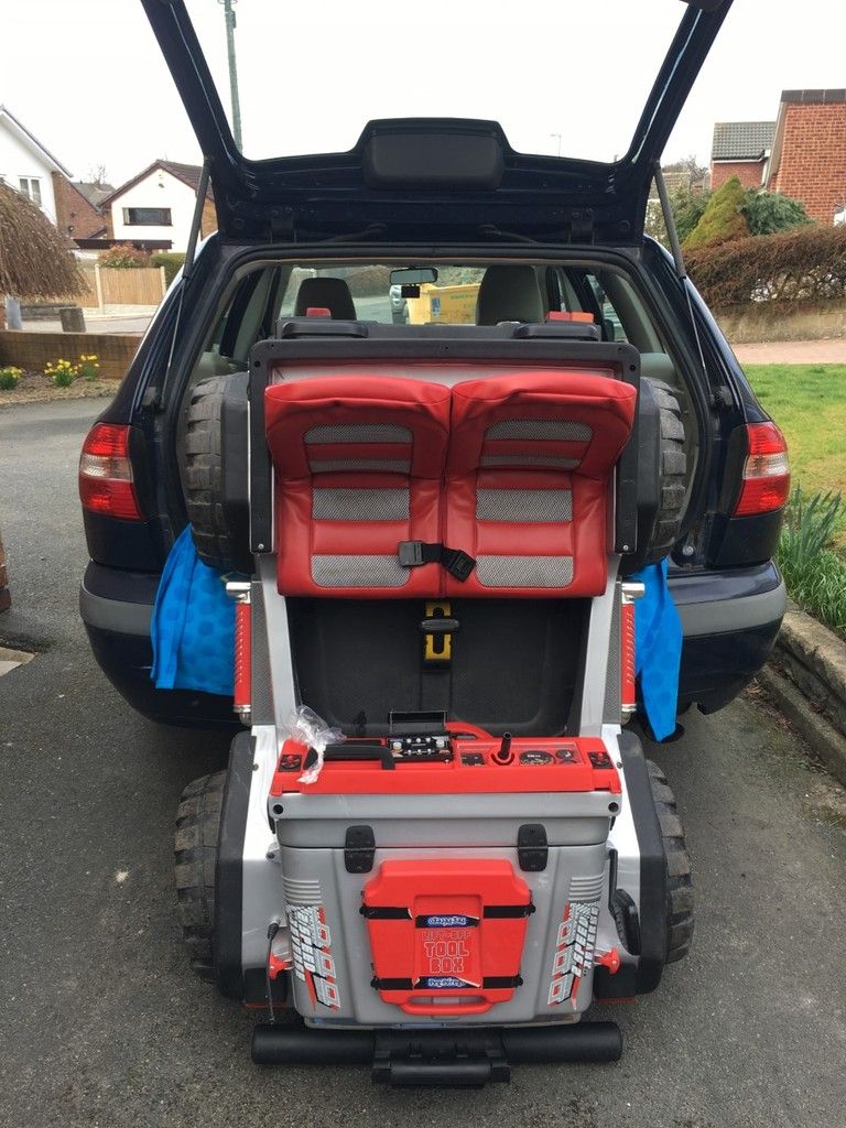

Hello all,
apologies for digging up an old topic but....
I've just bought my boy a Sivler Gaucho and need to collect it!!
Here it is!!!
Does anybody know if it will fit into the back of an Audi A4 Avant (Estate)?
I've look all over the web and can't find any dimensions, just the capacity in litres.
Obviously I could measure my boot, but I'm over 250 miles away from the car for the next few days and need to arrange a more suitable car it it won't fit.
Anybody had a Gaucho in the back of an A4 Avant before?
I know I can take the wheels/screen/cage off, but am still worried.
Thanks in advance,
Mike.

Hello again everyone, and special thanks to Dasilva100 and RacerX for the prompt replies!!!
I read enough to make me concerned enough to not make the 300 mile round trip twice, so went in the father in laws' people carrier!
All I had to remove was the roll bar, and it went in easy (with a UK Vauxhall Meriva).
I fear that it would have been a great deal more like Mr RacerXs' description in the A4, these things are really quite big!!
Okay, so now I've got it home, and realised actually how old it is, I'm amazed that I managed to get all the lights working, even the brake lights, and the motors.
The car itself is in amazing condition, and I'm very happy with it.
Just one question (for now...), I have connected a "normal" 12v battery to either the top 2 connections on the proper Peg Perego battery plug, or the bottom 2. On either pair, all the lights work, and so do the motors.
Ony thing is, the motors seem quite lazy in both forward and reverse gears, although that could be due to them not moving for years, literally! The longer I spin them, the quicker they seem to get, so could be fixing itself....
It could also be that the brakes are binding slightly?
The question is here..... how come all the lights go out, and the motors stop when I try to go into 2nd gear.
I have checked the gear selector restrictor, and that in the correct position (otherwise I don't think it would even go in....) but everything stops as soon as 2nd is engaged.
I have read something in the manual, and it refers to changing a plug under the bonnet that I cannot even locate.
I know it's on the left (as looking in the bonnet/hood) but there are no plugs to change!!!
Anybody seen this newby/fundamental blunder before?
Thanks in advance,
Mike.

mjh1 wrote:Just one question (for now...), I have connected a "normal" 12v battery to either the top 2 connections on the proper Peg Perego battery plug, or the bottom 2. On either pair, all the lights work, and so do the motors.
Thanks in advance,
Mike.
That model is recalled... I have had some of them and I always ask peg perego to send me a recall kit for free... After installing the kit there is a biiiig diference. The older wires create lots of resistance. I do believe the model you got has a plug for two 6volts batteries?? Can you put a pic of the battery connector to know exactly what we are we talking about?
