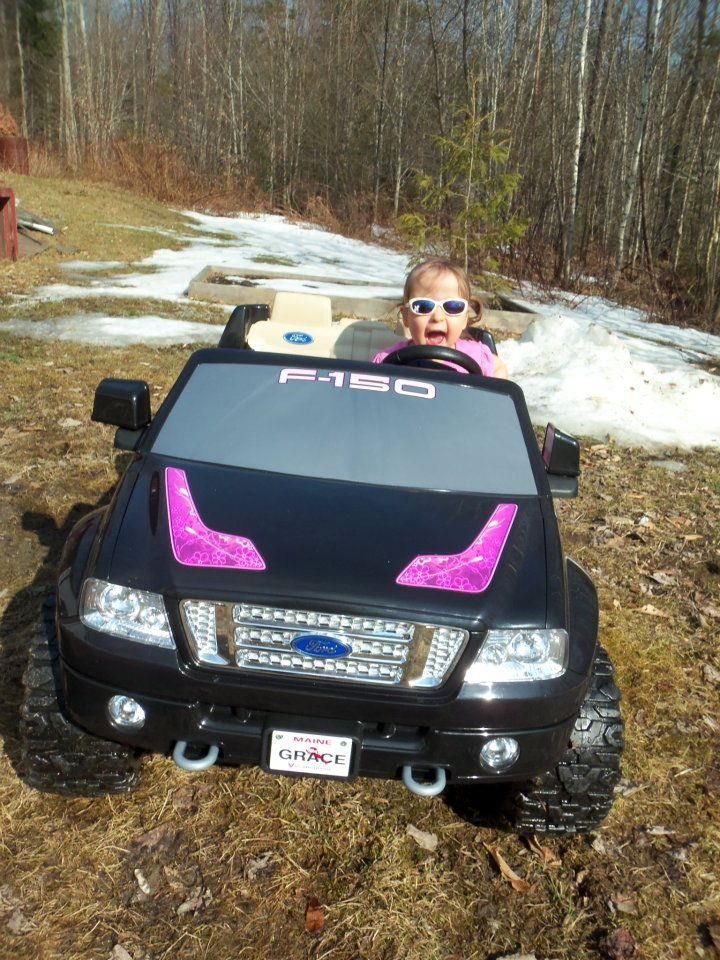

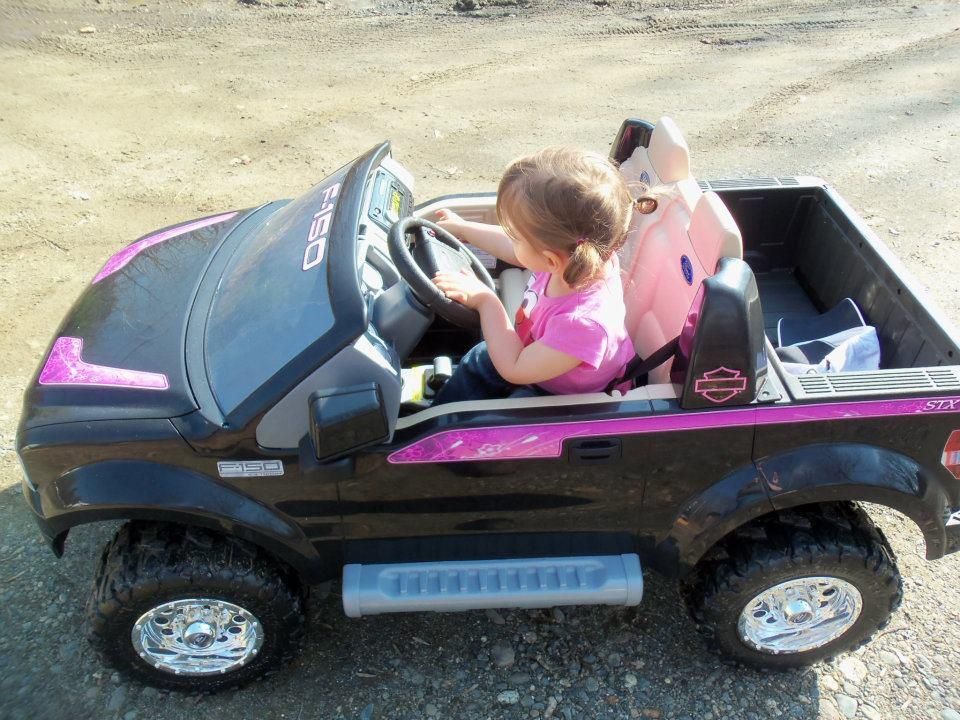

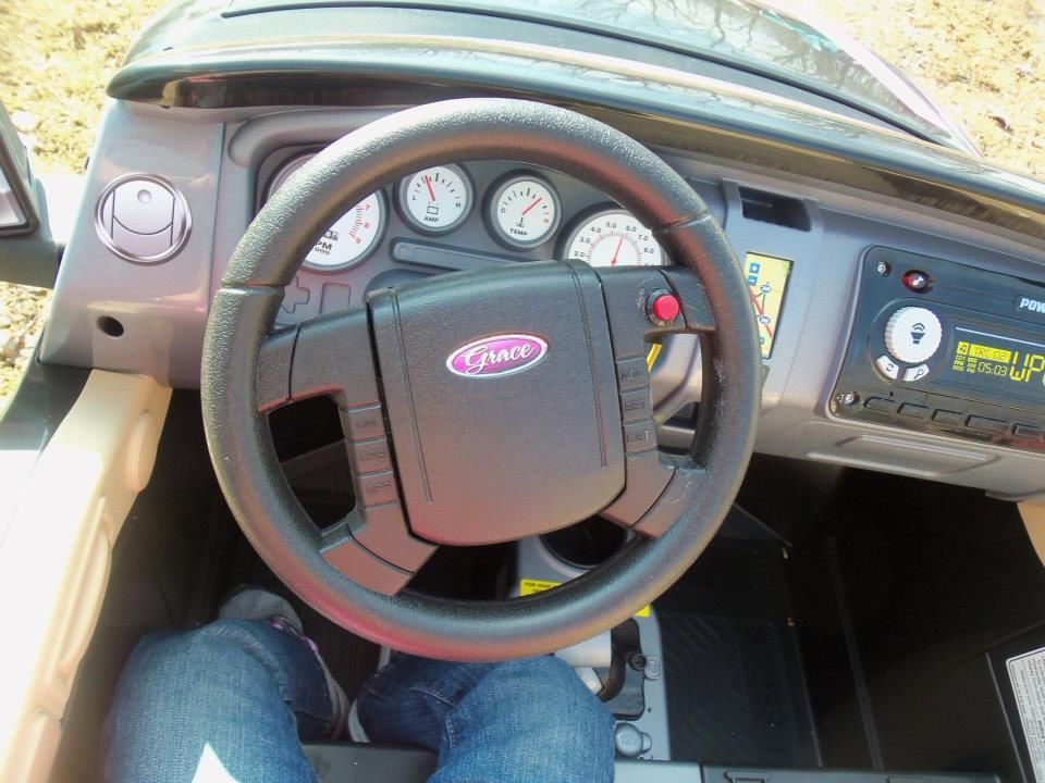

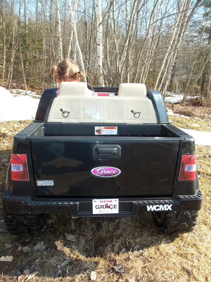

I haven't modded this truck much, yet. I did rewire the throttle to a momentary switch on the steering wheel using 12Vwiz's diagram because Miss Gracie's legs are parylized. We had a custom decal set made to make the truck more girly. I just ordered a programmable buzzer to make a custom horn. There are plans to mod in a rack and pinion to make less work of steering, hopefully we'll get going on it this weekend since there's rain in the forecast for the next week. I'm a stay at home Mom who is an aspiring modder. I no longer have the time to work on vehicles, I think PW are the perfect hobby to fill that void:) Those are NOT handicap symbols on her back windows, they are the logo for wheelchair motocross athlete Aaron Fotheringham who also has Spina Bifida like my Gracie.

Gracie's truck is AWESOME! I've just gotten a used F150 and want to get it running good as new in 30 days when grandkids come! Mom, you've done some GREAT work there! Can you tell me how best to get into the innards of the truck? From the Top or from the Bottom? I've got to see what's going on with the gears, so need some advice. Wondered how you did the electrical button for the accellerator?

Thanks! The best way to get to the wiring and gear boxes is to first remove the 4 screws that hold the seat down (2 screws in front of the seats -one tab each side, and 2 more screws behind the seats on each side where the seat meets the bed). The seat should come right out with those 4 screws removed. The easiest way to get the bed off the truck is to first remove the rear tires,(gently release the tabs on the hub caps to remove, then pull the pins and slide the wheels off of the axle) then flip the truck over to get at the 4 screws that hold the bed on. The cover that goes over the shifter just snaps into place, it will come off with gentle prying AFTER the seat is removed.
Here's a link to the owners manual for one of these trucks, the bottom of page 12 will show you where the bed screws are and it will give you a better idea of the break down of the truck.
http://www.fisher-price.com/inst_sheets ... r-0720.pdf
I used a diagram made by a member on this forum for the conversion to the throttle button on the steering wheel.
Here's a link to 12vwiz's diagram:
viewtopic.php?f=40&t=504
